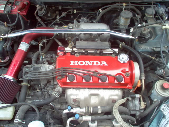

i painted, sanded, then clear coat. and i used a 120 fine grit paper, worked well didn't have to sand for long periods of time it came right off! .... i wish i would have taped those spots off, just wasn't thinking! i'll be taking paint off tomorrow in those spots!
yours looks killer rabbit!!

Did you use high temp paint? I used duplicolor.
Old May 10, 2007 | 05:42 AM
Default RE: my dyi's for the day....
If you want silver letters, sand them smooth before painting the cover... Then put chapstick over the letters and paint the whole valve cover. After the paint's dry, you can just wipe away the chapstick and presto-chango! The letters are still silver and you don't have to worry about scratching your nice new paint job. Then clearcoat it because the letters will eventually get dull and oxidized or whatever.

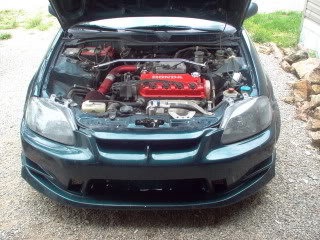

finished product(s)........ valve cover done, filter cleaned, and cd player in!
