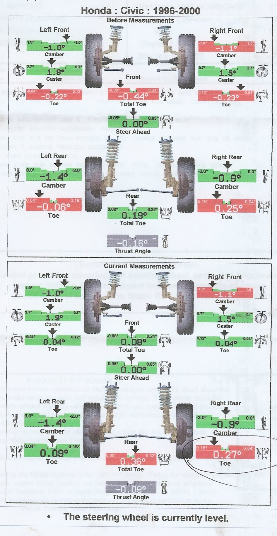

definatly get it aligned.... like said bad toe will kill your tires! heres my 99s alignment sheet before and after Stechs THO my one toe adjuster was frozen..
tho i did have like 3washers under each bolt of the rear upper arms. cause cause i dont like running negative camber.... to me it just looks bad... but wont hurt much if anything.....
