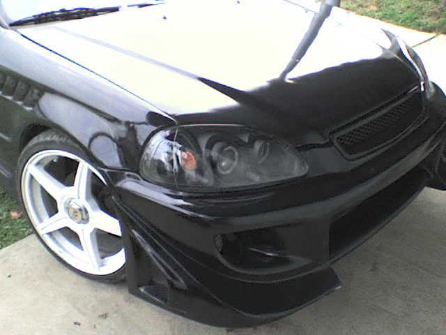

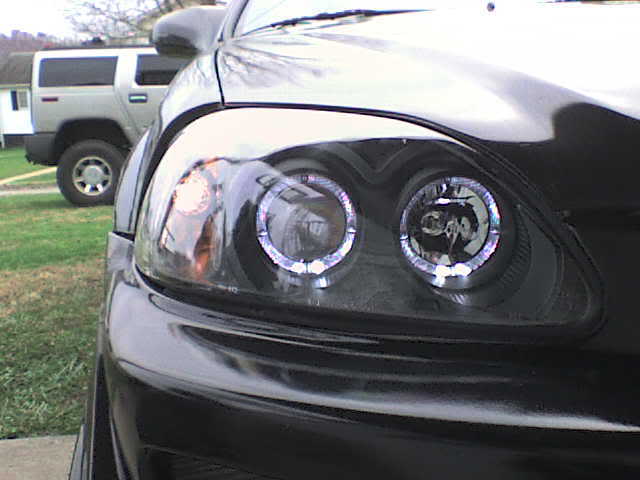

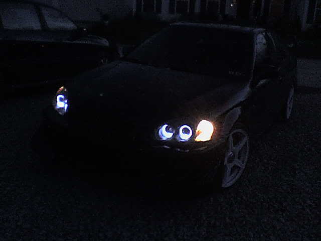

Crappy camera phone pictures... I would have gotten more but these turned out the best.
I'm considering eye lids but I'm not sure on them or not yet.
