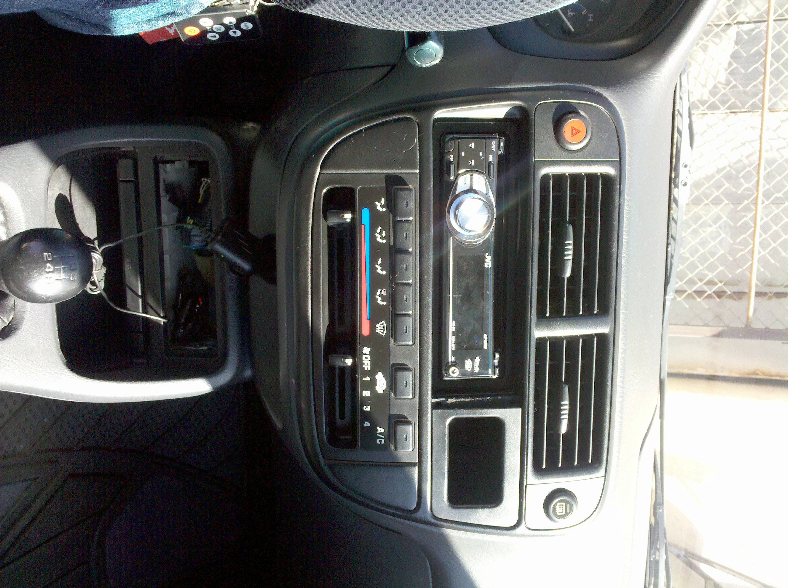

Hi guys,
I was wondering if the radio bezel in my 96 EX is replaceable, not by the same one, but by a custom-made one (if it's actually being sold somewhere)?
I installed a radio but it doesn't really fit right, so I want to replace the whole thing with a different...model.

upload images to photobucket, they resize automaticly.. you can replace it with a 99-00 civic bezel, it has a double din, BUT, its alot of work and a pain in the ***, they have tutorials here on hcf, just use the search button
Old Feb 20, 2010 | 02:12 PM
Or, we can link you to that one in the Interior DIY section if you'd like. Converting to the better looking center console requires pulling the dash and swapping the heater core out with a 99-00 one. Takes some time but if you have some mechanical inclination, it's totally doable.
