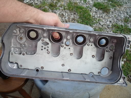

well FINALY i got my used valve cover......
and well its got quite a few marks all over it!!!!! even some factory molded flaws...
ive already cleaned the crap outta it soaking it in diesel fluid and engine cleaner for the realy hard stuff! got it all clean now... and painted it with some black high temp paint. and even tho it does look preaty good just painted... its got all kinds of scratches on it ontop. in the aluminum i guess
but do you think i should just some standard sand paper or like a little dremel and sometime of tool to sand it smooth?
also what grit should i use?
right now i just have it painted with the high temp stuff BUT before i bolt it on my motor i want to paint it with matching exterior paint..... i think it should hold up fine seeing how ive seen people paint big V8 blocks with car paint for a realy nice show look!

i used a wire brush on a air drill for the hard stuff then fine grit sand paper...then if i was u i would prime it sand that then paint it...that would give a very smooth surface...use low gloss and then clear coat it, also take some sandpaper and rub the black off the HONDA before u clear coat

i would get some somewhat aggressive sandpaper and sand it then repaint it and then wetsand it with some fine grit paper and then paint it one last time and you should be good to go with it being all smooth

Get some flapper sanding wheels and use those to knock down the high spots. Then make sure and use some good primer to fill in the low spots and add a couple of coats of paint... it should all be mostly gone or hidden then.

Just use a rotary grinder with a semi-fine grid wheel and be careful, you could really mess up the aluminum.
Don't do it too much on the pitted place. And by the way, I used the same semi gloss, and you don't need to clear coat it (even
if you polish the honda) or it will look a little wierd. I did mine this way. Just look at my profile, that's what it should look like when complete.
