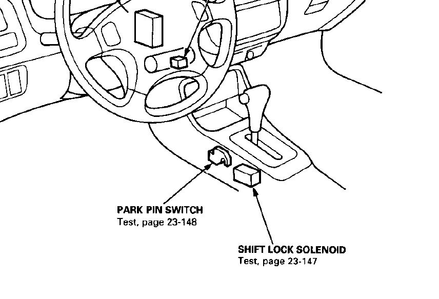

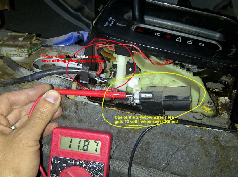

Ok here is my results. I wasnt sure if you were talking about the Park Pin Switch , which has a couple black wires or the Shift Lock Solenoid (which has 2 yellow colored wires)
The Park Pin Switch had virtually no voltage when key was turned for on all 4 wires ( 2 red , 1 white , 1 black)
The Shift Lock Solenoid did get nearly 12 volts on one of the yellow wires when they was turned. Please see photo. I only tested while in Park position. I am not sure what my results indicate. Please advise for next troubleshooting / repair steps.

I don't think it is either of those. Those seem to be involved with the interlocks where you can't shift out of Park without pressing the brake, and you can't turn the key all the way off to lock the steering without shifting to Park.
Is there another switch on the other side? The other switch would control the starter and the reverse lights on the back of the car.

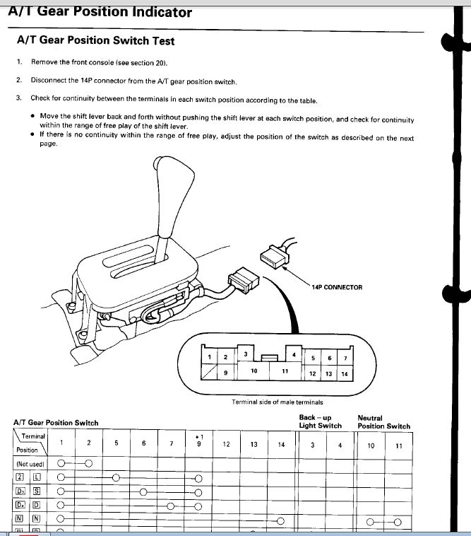

A/T position switch results:
Looking at the previous service manual photo. I get 12 volts on wires #10 and #11 when the key is turned - passed on for ignition. There is also constant voltage on the #1,2,9,6,14 when the key is on. Does this help? should I test for continuity on the A/T position switch? Please advise and thank you.
