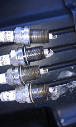

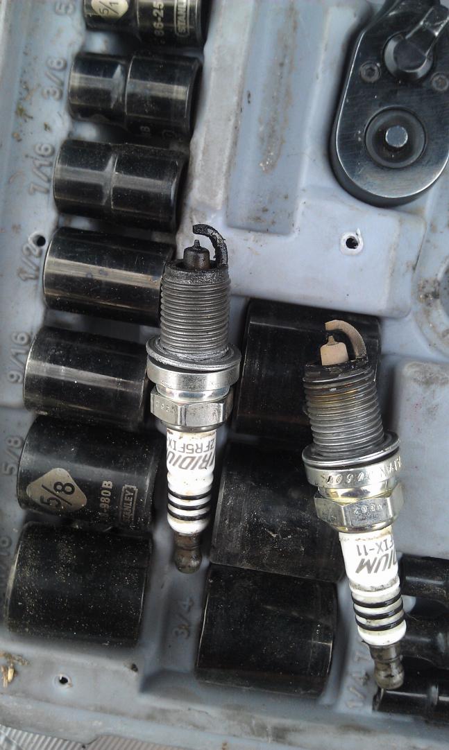

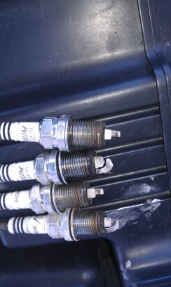

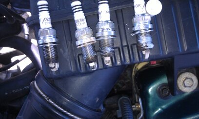

I pulled the plugs the other day and heres a pic
The pics with all 4 spark plugs is when I pulled them the first time. The pics with only two spark plugs the dark oily looking one was in cylinder 3 but before 200 miles it had that white ash on it.

Proper valve adjustment is very important. Do it yourself or at least check it, don't trust someone else. It is normal to hear some clattering valve noise when the engine is cold. If the valves are too tight it will misfire especially at idle.
If you're getting a lot of oil on the plug the rings could be bad. How is the compression?

It had white ash build up before it had black oil on plug
