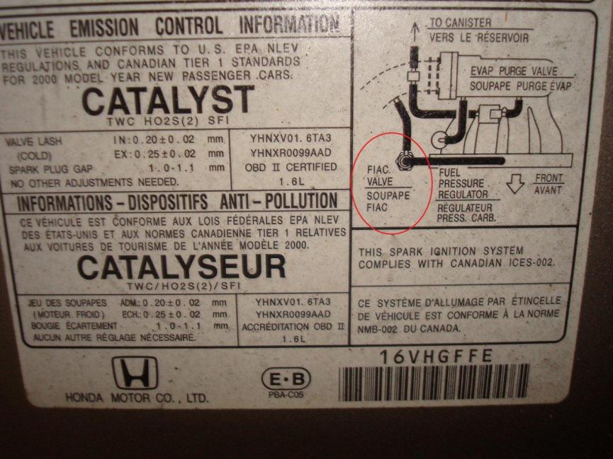

Today, I did some more testing again.
I blocked all the nozzle to the intake manifold, blocked the TB, unplugged IACV conntector, but the engine is still running at 750rpm.
I still hear some air leaking sounds from the intake air duct.
There's the air temperature sensor and 2 ducts coming from the engine.
One duct, there is air coming out from engine, so that cannot be it.
The other one, on the contrary, is sucking air.
So I removed the tube from the intake air duct and blocked it, the engine died right away.
Since I blocked all the air entrance to the intake manifold, the only place air that can go in is the TB screw and this tube.
From the diagram on the hood, I assume this is where the FIAC valve is.
I have no idea what is the FIAC valve and never heard of it. I also cannot find much information about this.
Can anyone tell me what is this, and should it suck air?
I attached some pictures regarding this.

Your second picture is the FITV (Fast Idle Thermal Valve) mounted on the thermostat. It is supposed to close fully when the engine is warm.

I did a lot more research and find that the FIAC valve only exist in the 99-00 models!
It is same as FITV. Since it is wide open when the car is warm, something is wrong with the valve!
I ordered a new part from Honda, and it costed my $157.03!!!
I will try to clean it and see if it works. If so, I am going to refund my new valve.
