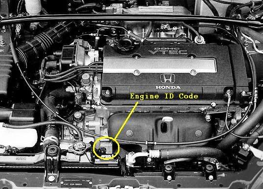

A visual for example. Most older Honda engines have the ID plate here:

It's a D15Z1 motor is what the guy tells me. If i swap only the motor it wouldn't make my milage drop to like 20mpg or anything would it??

Whoa, hang on. I'd guess you're running a D15b2 engine currently. It has 92 HP.
D15z1 is a different story. It's the Civic VX engine, VTEC-E, made for high fuel economy through lean burning. Has roller rockers if I recall. It's a 90 HP engine.
