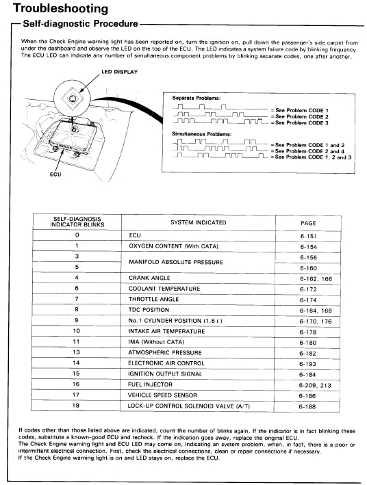

Is the LED on the ECU blinking any codes?

The ECU is under the carpet on the firewall where the passenger's feet would be. Pull the carpet down and there is a small red LED behind a window on the ECU itself. Turn the key on (do not start engine) and watch the LED. If it starts blinking there is a code stored. Count the blinks between pauses.
