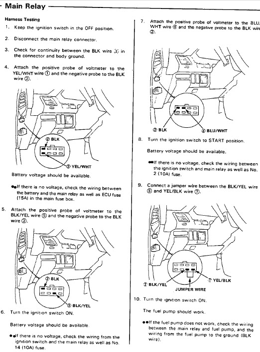

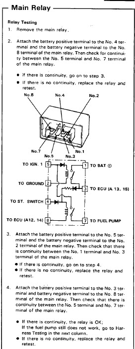

Old Apr 7, 2008 | 08:29 PM
Default RE: 91 Civic Dx 1.5l Trouble starting after driving
Here's how to troubleshoot the main relay and its circuit:

After coming to a conclusion that I am not that skillful to testing out electrical components, I started researching similar problems. Many civics this year (89-91) have problems with starting the car shortly after driving it and noit being able to start until the car has sat for about 5-10 mins. There are 2 parts, a ingnitor and a main relay. Can someone tell me what the designated jobs of these 2 parts are. What would be the cause of me not getting a spark to my plugs when the car is warm after 20 mins or more of driving. I would like to gamble on one of the two but would like to see what I am dealing with. Thanks, for all the info so far.

I had the same problem with a 90 civic, startes fine when cold, but won't start when warm, let it cool down 15 min. and off you go. Also no spark at the time.
The problem was the main relay, the solder joints inside the relay were not that good from the factory.The main relay sends power to the fuel pump, and the ignition, this happens all the time that the car is on. It creates a lot of heat stress on thesolder joints, and they tend to fail whenhot, when they cool off they contract and remake the connection.
The car will still crank over, also a function of the main relay, but until the relay is cool enough I got no spark.
If you pry the plastic cover off of the relay, you will find inside a circuit board with a dozen or so solder joints. Reheat these spots with a good soldering iron, and any problem with bad connections should be solved.
This relay seems to be a source of a lot of problems for honda's from the 90's, check the problems solved page and you will find detailed instructionson how to make this repair.
