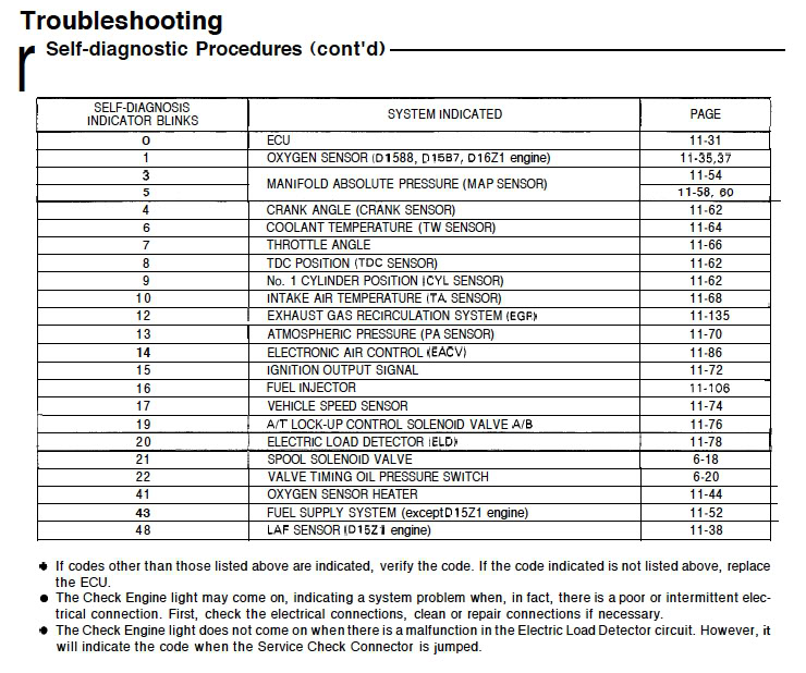

It did it when it was cold. I have replaced the ignition coil, the igniter and cap and rotor. It still wont start.It is showing a engine code of 48 now. But I can find out what the code is.

A bad LAF sensor (similar to O2 sensor) (code 48) is unlikely to cause a no-start condition.

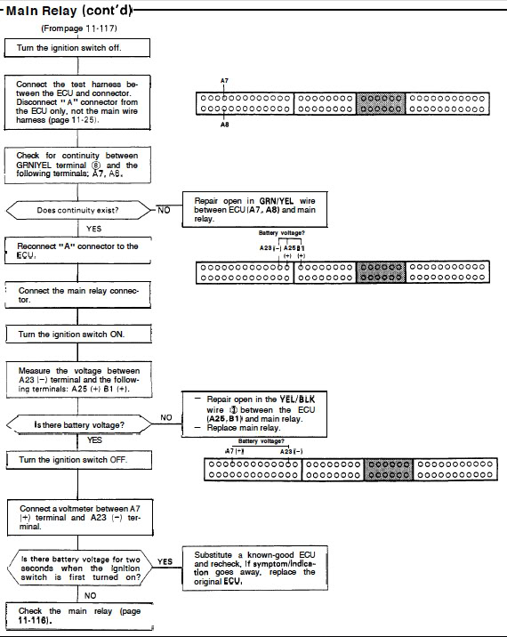

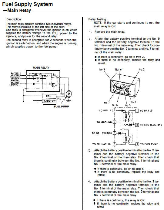

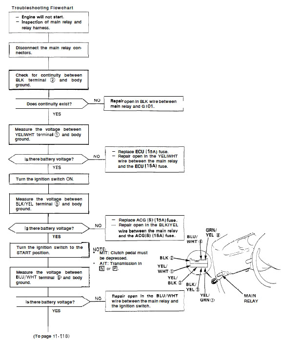

Please state whether this summarizes the current problem: The starter cranks the engine but it has no spark at any of the plugs and the fuel pump does not prime.
If so, I recommend that you:
1) carefully recheck for blown fuses.
2) test whether the distributor connector has battery power when the ignition key is turned to ON.
3) test whether the main relay makes several click sounds when the ignition key is turned to ON. If not, test whether the main relay is receiving battery power and whether the relay is functioning properly:

More troubleshooting information is needed to help you find a fix.
Again,
1) Does the starter crank the engine?
2) Is the connector to the main relay receiving battery voltage with the ignition key turned to ON (see diagram above)?
3) Is the connector to the distributor receiving battery voltage with the ignition key turned to ON?
