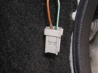

3) Locate the jumper plug (Civic 92-95 is grey, 96-00 its blue). Its a 2 pin plug.
(I am not sure if the connector is in the same location for all hondas..I assume so - I dont know all the connector colors...)
For EK, there is 1 brown wire and 1 black wire
For EG, there is 1 tan wire and 1 green
4) WITH THE CAR OFF, insert either a 2pin connector clip, or loop a thin enough piece of wire into both holes on the connector.
5) Back in the driver's seat, turn the key to the 'ON' position. The CEL light will come on at startup, like normal, but it will then begin to flash.
