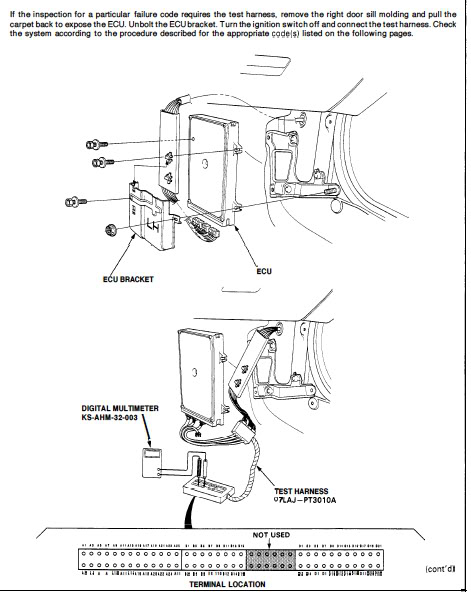

Post the numbers you see on the ECU. It's located behind the front passenger kick panel.

well ive been talking to the guy i bought the car from and said he swaped the ecu and the motor, just not the wiring harness. so should i buy a d16 wiring harness? where are the numbers on the ecu? ill post em to make sure

its a p28 ecu.
