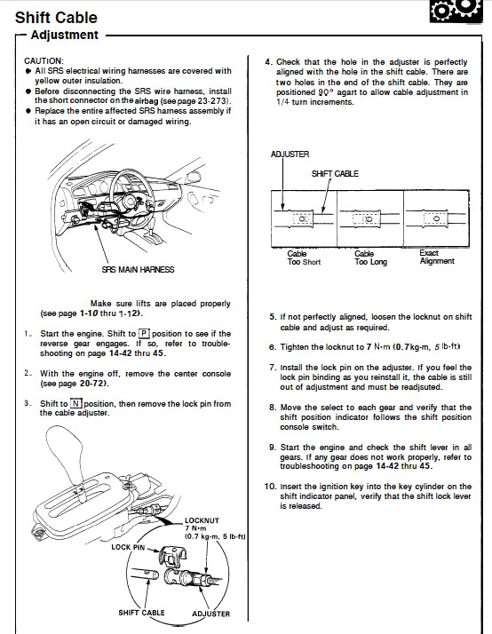

Check that the lever on the transmission moves all the way to park when the handle in the car is on park. I think it is marked. Very likely one of the ends of the cable have broken loose and the cable needs to be replaced.

Thanks i will check that . It was dark when i left this morning . As long as i am going foward car is fine nothing abnormal. So i think the transmission is fine unless converter locked up over night when it cooled off

Shift cable out of adjustment?

have not got to cable yet . Just was shocked when i was looking to go backward and went foward .

Cable funtioning fine and lined up . Seems more like it froze its self in foward gears. When in poark it does lock the car but still pulls a gear. Same with reverse . Anyway unfreeze it or release all of it
