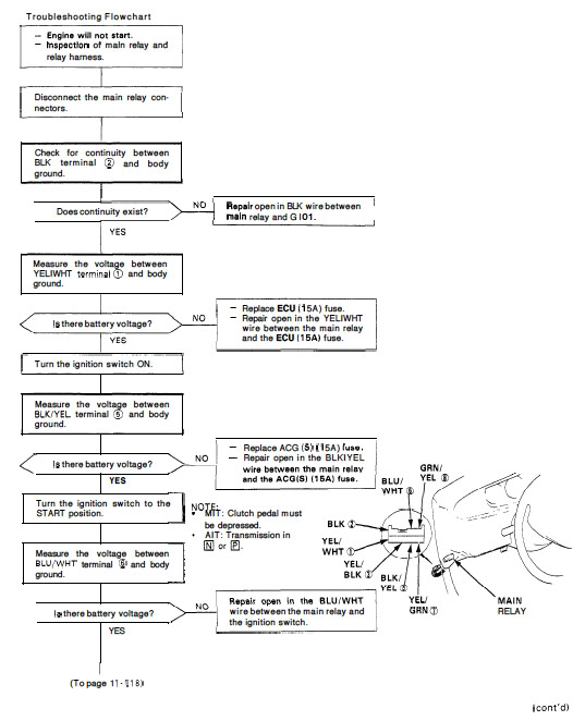

You should consider that the short in the Service Connector and parking lights circuit is related to the lack of power to the main relay. I think that if you locate the Service Connector/parking light short circuit or the damaged wire between the battery, ignition switch, and main relay, then you are likely to find the source of all the problems.
Edit: What is the outcome of the tests in the diagram?
