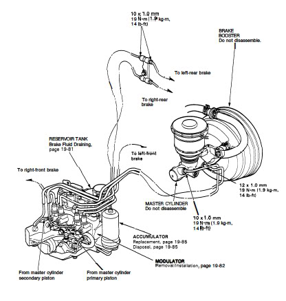

Look for an ABS light on the gauge assembly and for an ABS control unit connected with brake lines to the master cylinder.
