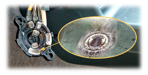

If you have a D16Z6 engine, I think premium gas doesn't benefit the performance and just costs you more money. In addition, your ignition timing is set to run regular 87 octane gas.
My first thought about your problem is a bad ignition switch in the ON(III) position. Can you push start the engine without a problem?
Old Aug 21, 2009 | 12:53 PM
i'd say its in your ignition
does your dash lights(cel,brake,oil) lights stay on or do they go off when it dies...

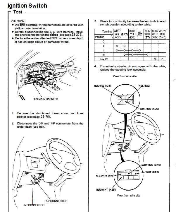

Old Aug 21, 2009 | 12:59 PM
If the switch tests bad, then replace it.
Edit - correct diagram for 92-95 Civics now shown below

Old Aug 22, 2009 | 06:32 AM
Originally Posted by Young Blood
Ok, Im not sure about the push start thing. But here is what i noticed. I pulled the number one plug wire and had my wife crank it over and there was no spark while she was cranking it, but when she let it go, it would spark as the engine finished its last rotation. Also it kinda diesles a little after letting go of the key and you can hear a "pffff" kinda like comprssion at the end, and I smell fuel strong around the throttle body but dont have anyleaks.
This is fully consistent with a bad ignition switch. When you test the ignition switch, it predicts that Bat and IG1 will fail the continuity test with the key in ON(III). Do the ignition switch tests in the diagram.

Old Aug 22, 2009 | 06:39 AM
If the ignition switch turns out to test bad, as I predict that it will, then read this thread, which will describe a relatively easy and inexpensive fix.

Ok im going to do this right now. Would this switch of caused it to stall while driving down the road?
Old Aug 22, 2009 | 06:51 AM
Yes.
*****Above, I have now posted the correct 92-95 Civic diagram for testing your ignition switch. The previous one was for 96-00 Civics.
