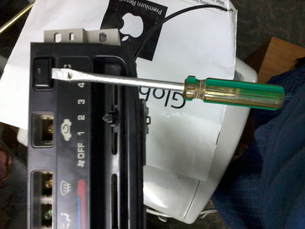

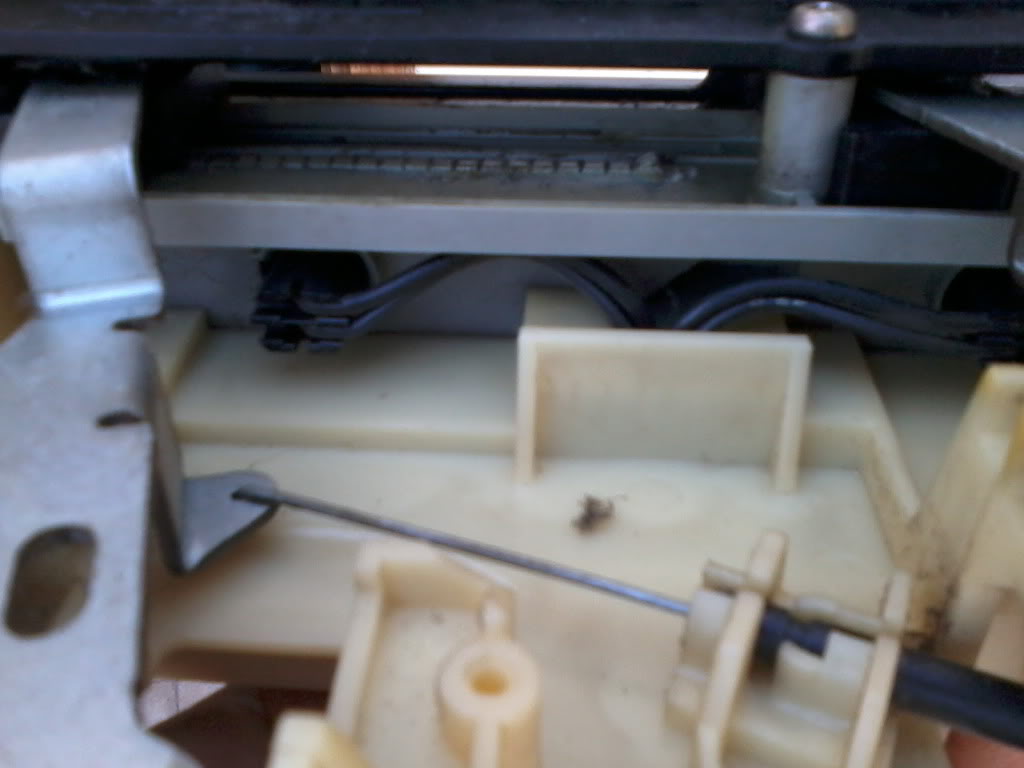

These were the old pictures I have taken a few months back. Can't find the climate control anymore so I can't take better shots.

thanks axis11. looking for that cable at the bottom of you picture and i cannot find it. i know it used to be there. heat did work a while ago. oh well. i ll keep looking or take it someone. thanks for the help.
