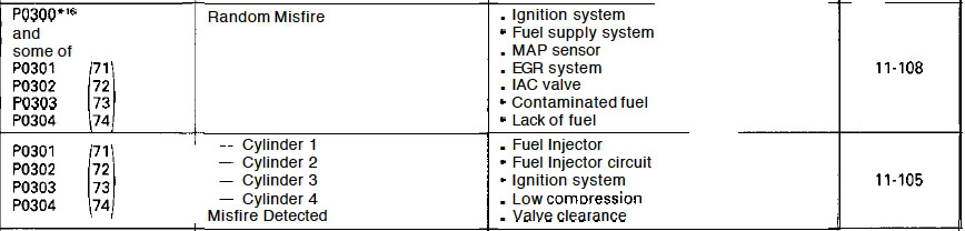

The blinking of the CEL indicates misfiring severe enough to damage the catalytic converter. Hopefully, you didn't drive very long under these conditions. What were the CEL codes?
How many miles on the engine and when was the last time that the plugs, wires, distributor cap, and rotor were replaced?

the car has 135K on it. i replaced the dist. cap, roter, and plug wires Jan-07, put about 34k on since then. after i got the car back from the mechanic i replace the plugs. haven't tried compresson testing yet, and i was thinking of the fuel system pressure. but still looking to barrow a tester. not sure about the codes i'll call and ask if they still have them.
