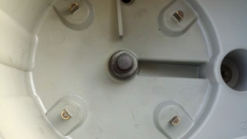

Old Jul 27, 2011 | 10:39 AM
Here's an example of what a cap in good shape looks like. (I recently checked mine.)
If yours looks similar, you may not need to replace it.
