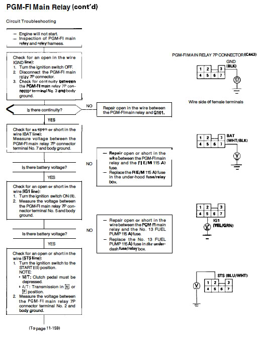

I HIGHLY recommend that you carefully double check ALL fuses under the hood and dash. If no blown fuses are found, then here"s how to troubleshoot:
