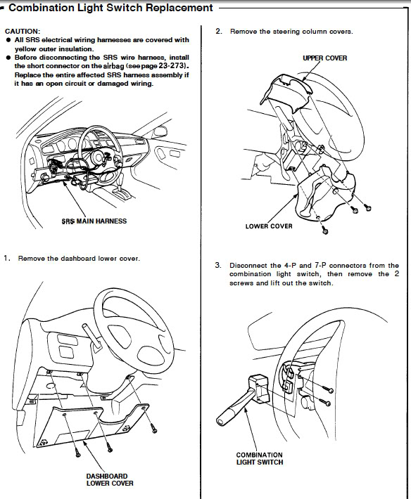

Old Aug 8, 2008 | 12:45 PM
It is called the combination switch. You can definitely replace it yourself. You also might save money by getting a used one from a salvage yard.

Do you have an aftermarket alarm system or other modified wiring? The reason I ask is that ordinarily the brake and reverse lights don't have anything to do with the combination switch.
It's relatively easy to replace the switch, but if you have a driver's air bag in the wheel you have to follow some exact procedures related to it.
