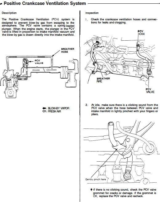

Someone recently posted on the forum a similar problem with a 5th generation Civic. The problem turned out to be a bad PCV. I can't say I really understand why this would be so, but there you are.

Interesting, do you have a link to the thread? the pcv is the only thing i havent replaced yet

Sorry I don't remember the link. If I find it, I'll post. In the meantime:

I still haven't found the thread, but an answer found on WikiAnswers seems to make sense:
"A stuck-open PCV valve will allow unmetered vacuum to cause a lean air/fuel mixture. The engine management system will "fatten-up" the fuel injection spray time (volume of fuel) to compensate for a lean air/fuel ration, thus using more fuel to accomplish the same task. It can cost you at the pump & cost you in damaged engine-related repairs. Change your air filter every 10K miles & your PCV valve every 25K miles."
