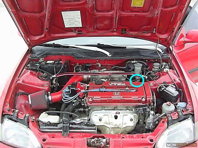

You mean the bolt outlined in green here?
The bolt that holds on your valve cover (I understand you have a different engine). I have the same problem, but mine is sealed with hondabond (a liquid gasket) and it works perfectly, although I'll be getting it fixed as soon as I can.

"got a pick of the bolt? if its a manifold bolt those things are cake to fix"
its the part of the cylinder that is broken. The bolt is not the issue , there is nothing left of the
receptacle that the bolt goes in someone torqued it and cracked the bolt receptacle. The bolt comes down thru the gasket
but since it can't close tight on that side of the gasket the oil leaks out . The manifold is below the cylinder and not the issue.
any ideas anyone ? buying a new head seems too much,
Carlz0r yes thats like it , but its a differnt gasket so there a 5 bolts not the 6 you have there but...yes.
