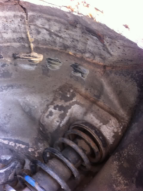

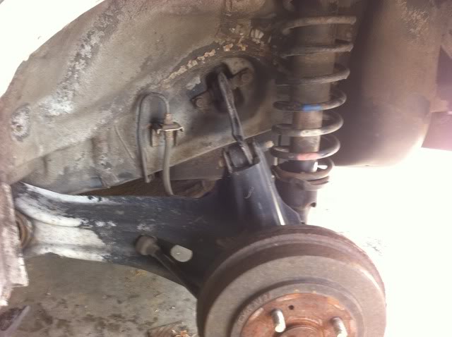

My girlfriend moved in with me last week. we loaded all her stuff into the back seat and the trunk and hauled it home (about 90 miles @ 70mph) and also had to keep some of the stuff in the back for a few days while i made room for it. after i unloaded everything, the back end loosk a bit low to me by maybe half and inch. now when i make some right hand corners at speeds i always take them at, the rear tire bottoms out and rubs the wheel well. I dont really see anything broken, so im thinking i blew the shock/strut (not sure which it is). What should i check to make sure thats what it is. also, is this something i could try to do myself without access to airtools.

both sides look about even... but it does kinna look like the back sits lower (only thing in the trunk is a 10" sub in a small box and a maybe 30lbs toolbox. finally got around to pulling a rear tire off and i dont see any thing broken or bent...
