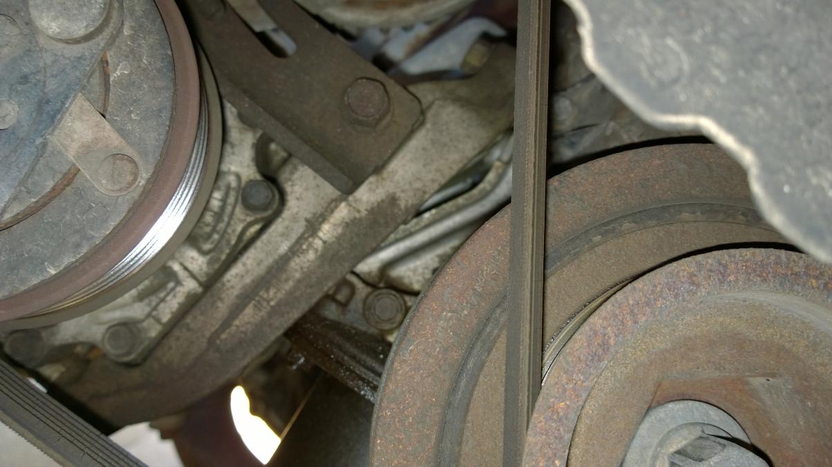

Ok so I guess I spoke too soon, because it's still squealing.
First off, I am having issues because I have no idea how to tighten the belts, so I need some help haha. And second, I have a picture, and both of the belts have cracks, so I think I might need to change them.

If your belts have cracks in them then should be replaced. Cracks are going to get bigger and then the belt could snap. Then you're going to have more problems then just fixing a belt.

I personally can't say because I don't know your mechanically inclined or not. Some people don't know how to change a tire or put air in a tire. Others can do engine, transmission swaps. Everyone has different levels of expertise. If you can't do it then I'd take it to a mechanic.

This would involve loosening some bolts, prying on the alternator and/or power steering pump to slacken the belt, remove belt and put on new one, then move the alternator and/or power steering pump into position so the belt is tight, then tighten the bolts.
