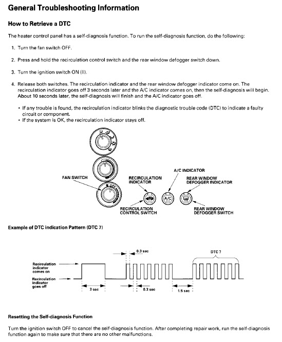

Have you tried to retrieve a trouble code (see below)?
