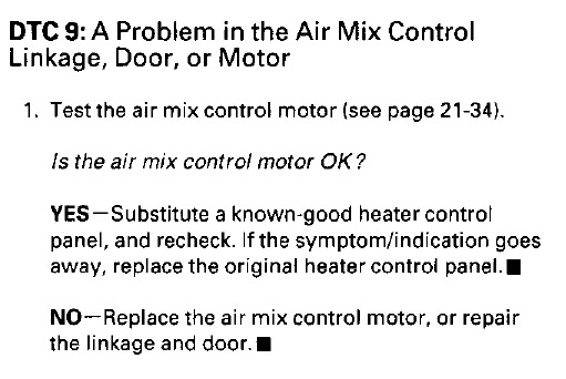

Ok a little bit of an update. It took a few to get ahold of him to get him to come. But I tried pulling the codes and I got a code 9.
Do you know what the code means?
Do you know how to clear the code?

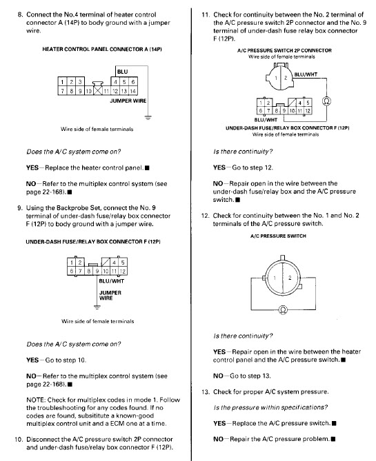

Old Jul 30, 2008 | 07:17 PM

That's what the diagram in post #5 suggests.

I tested for power at the Yellow wire tonight and I am getting 6.90 Volts to the Yellow wire. I had a mix up about the Blue/white wire. I thought it was supposed to be the Green/Red wire. So I will have to retest that again when I can meet up with him again. He showed up at 8:30 and the Bugs were eating us alive so I had to stop for tonight.
But as for the code 9 the motor is weak and 90% of the time only moves half way. He is getting a new motor tomorrow.
I am still a little baffled and trying to figure out if that code would stop the A/C from coming on.

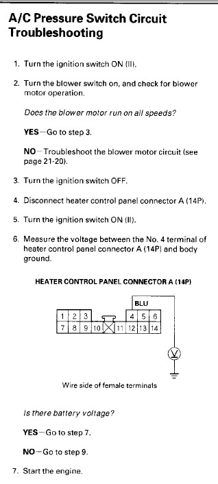

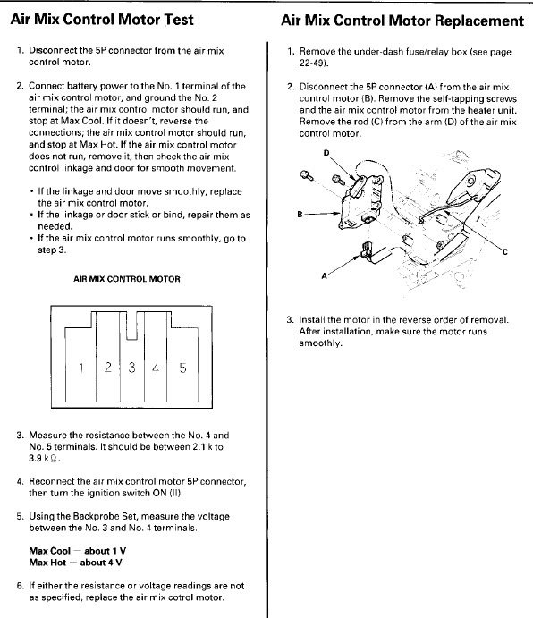

Old Aug 12, 2008 | 06:30 PM
Based on information provided thus far, here's how to troubleshoot the problem:
