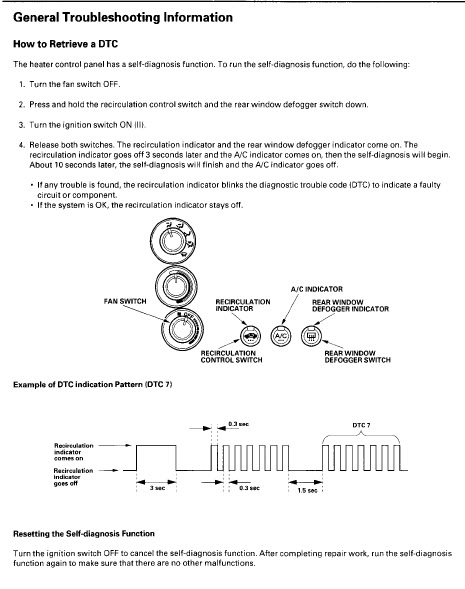

Try to retrieve a trouble code:

I got a code 12 doing the self diagnosis. I believe it means the power transistor module is gone. Also there has been bits of filter coming out of my vents. I will check both and see what happens. Thank you very much for your help.

hmmm code 12?? isnt that an obd1 code?
an obd2 code should be P1234 something in that order

The OBD/CEL trouble code system is different from the HVAC trouble code system.
