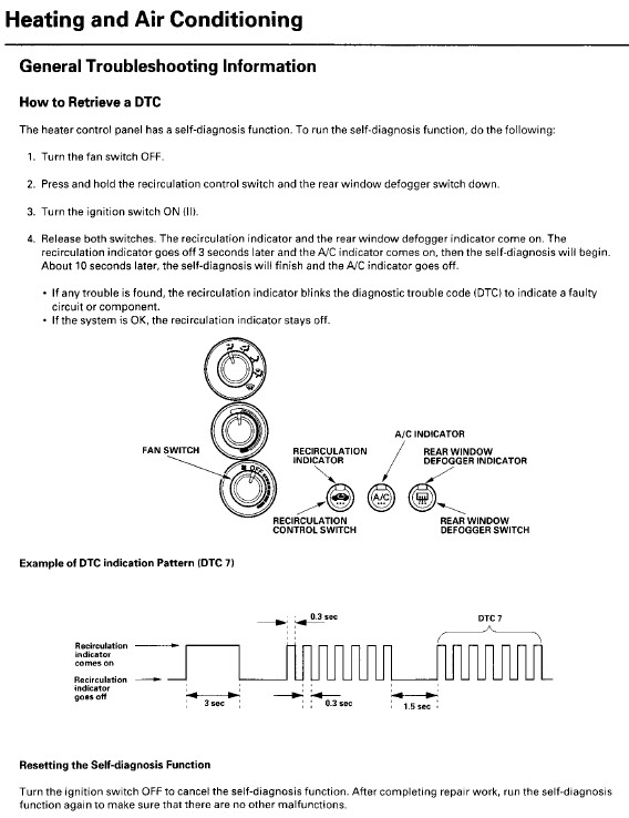

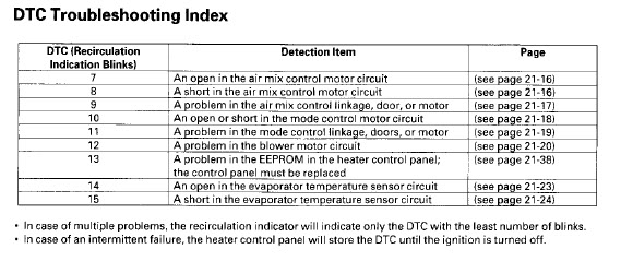

Old Jun 24, 2010 | 05:03 PM
Do this:
Old Jun 24, 2010 | 05:09 PM
scphoneguy's Avatar
Posts: 5
It blinked 12 times. Where exactly is the blower motor circuit?

Old Jun 24, 2010 | 08:03 PM
mk378's Avatar
Posts: 10,023
Interior fan (blower) not working and a code 12 from the control panel is almost always a bad power transistor. But you should confirm that there is no voltage reaching the blower motor first. Measure between the two leads with the plug still plugged in. If there is voltage at the motor but it doesn't run, it's a bad motor.
