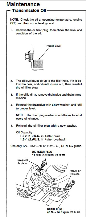

Maybe a problem with the transmission? Is the transmission fluid low?

i have no idea... idk how to check that

Default RE: can any one help??
Here's how it's done for a MT:
