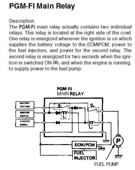

ORIGINAL: me262dave
All electrical power goes through the main relay; fuel pump, ignition switch, ecu, spark plugs.
You are correct when you say that the main relay controls the fuel pump. It also controls power to the fuel injectors and ECU, but not the spark plugs, ignition switch, or most other electrical components.
