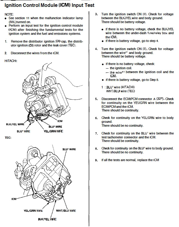

Originally Posted by Got-a-D
i bought a re-manufactured one
okay ill check voltage when i can get a ride to get a tester
what steps should i take after if it is not getting voltage
If there's no voltage, recheck fuse 9. Test for voltage at the two top test taps while it is installed.
If there is voltage, then do these additional voltage tests inside the distributor:

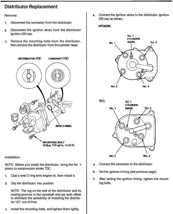

okay so distributor was bad and replaced it now and i get spark to all for ignition cables. still no start.
any ideas?
Old Jul 10, 2010 | 01:23 PM
Did you install the plug wires in the wrong firing order on the distributor cap?
Is spark bright white?
Some aftermarket distributors can be installed 180-degrees out of phase. Might this have happened?

Plugs are good firing order.
tried it both ways and one way wouldn't start the other way made loud noise still no start
Old Jul 10, 2010 | 04:50 PM
Does the fuel pump prime? Any CEL codes? Is spark bright white? Is the mechanical timing off by a tooth?
Firing order
The cylinders are ordered 4-3-2-1 from the distributor to the timing belt:
