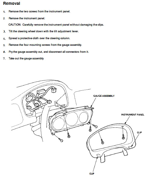

Old Jul 10, 2010 | 08:16 PM
  #35
The CEL bulb is burned out or a previous owner removed it to hide CEL codes.
Have you checked for codes with an OBDII code reader?
Remove the cluster to check the CEL bulb:
