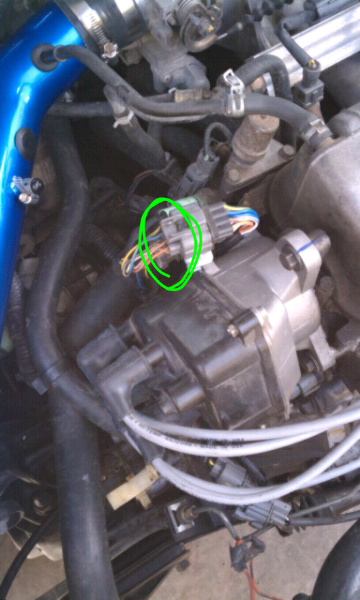

Well I had everything checked out, and turns out I'm not getting current here:
Could that mean my ECU is messed up?
Old Jul 29, 2010 | 10:53 AM
distributor sends signal to ecu. find someone with a distributor and try theirs
