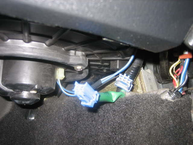

my friend said that connecting this 2 prong clip, found under the glove box, with a paper clipmight be able to reset the code. not sure about this, never heard of it, but i trust he's not making shiz up since hes not completely dumb when it comes to working on cars.

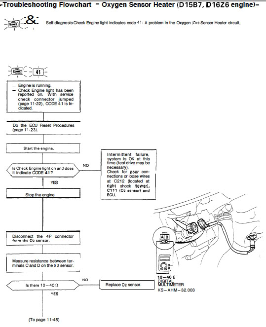

ok nvm, i'm a bit impatient esp if theres something wrong with my car so i ran out and did this real quick. it worked just fine. came out to being 41: primary oxygen sensor heater. heater? i've never heard of this. my o2 sensor is also only about 2 1/2 years old. ugghhh damn sensors.

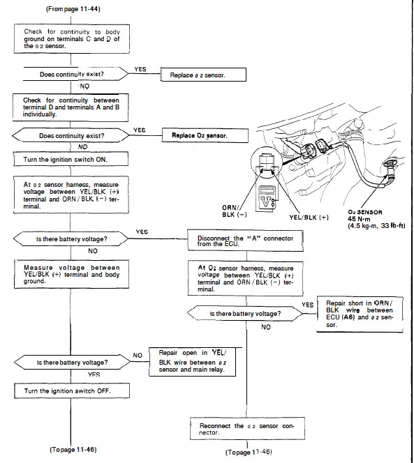

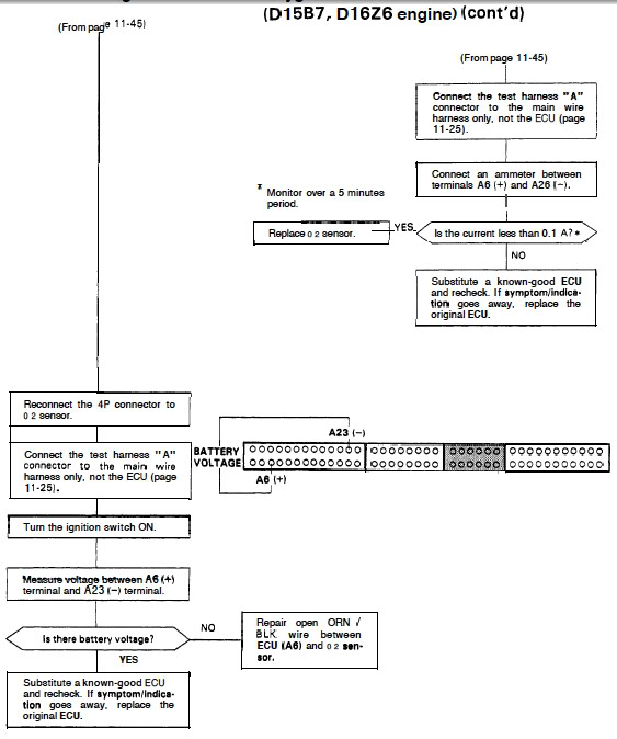

The O2 sensor only works properly at high temperature, so it has a built in heater to ensure accurate readings.
Using a multimeter, you can figure out whether the problem is in the O2 sensor itself or in the circuitry leading to the sensor:
