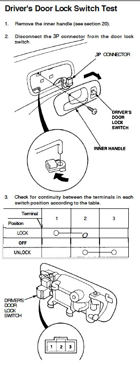

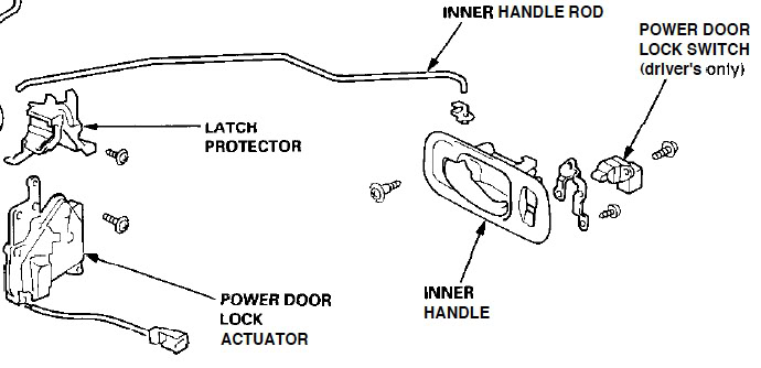

Is the locking and unlocking problem happening for only the driver's lock or both the driver's and passenger's lock?
Maybe the door lock switch is bad. Check whether any pairs of the three terminals of the driver's door lock switch (1+2, 1+3, 2+3) have continuity while the switch is in the OFF position (see diagrams below).

Where is the lock switch mechanism located in your Civic?
I sprayed driver door switches with W/D40 to repel any moisture on them. Now central locking has chucked it.
I don't think that spraying WD40 on electrical switches is recommended. What switches did you spray and where are they located. Can you post a picture?

My guess is that replacing the driver's inside door lock switch will solve the problem.

Ron, you are right. When using the key, it only unlocks the door and not the opposing door. The driver's side only have the controls from the inside to control both locks. My guess the inside control for the locks is the culprit. If the problem comes back, I would replace the switch too.
