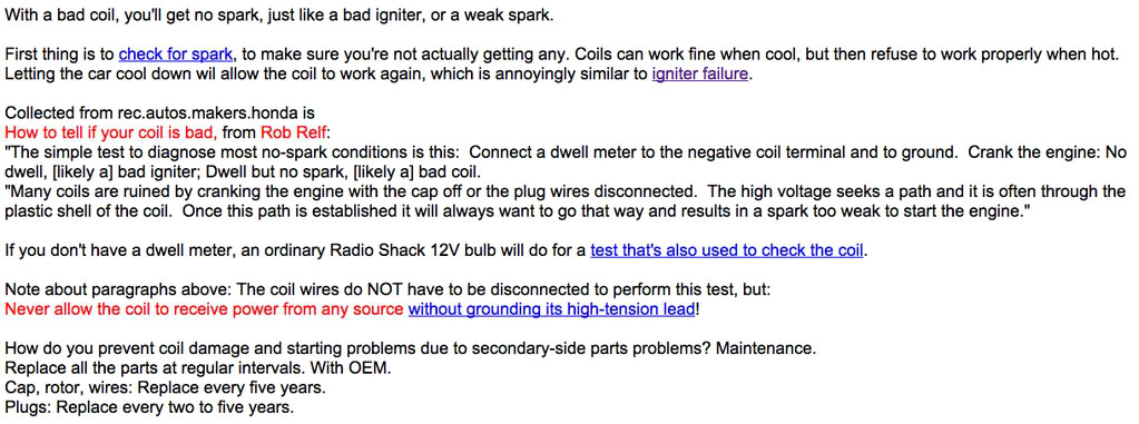

Information at the link below suggests that removal of either the distributor cap or a spark plug wire when cranking the engine runs the risk of damaging the coil. Consistent with this idea, on this forum during the past year, I have read several different threads where removal of a spark plug wire has apparently led to a blown coil.
http://www.tegger.com/hondafaq/start...s.html#badcoil
Quote from above link:
This link also covers many other topics about Hondas, if you happen to be interested.
Note, by posting this information, I am in no way attempting to discredit mk, who is a highly knowledgeable mechanic that I respect and who has likely performed these tests without damaging any ignition systems. Instead, I am presenting information that suggests that performing the tests carries some risk, especially in the hands of a less experienced mechanic.
