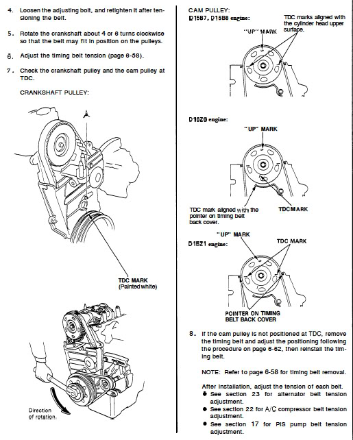

Any CEL codes?
How old and worn/corroded are the plugs, wires, cap, and rotor?
Have you checked the mechanical timing?

Well I've replaced the cap and button not much change it still sputters when I give it too much gas If I let off it runs normal and at idel it's not stable it hunts a bit and and it feels like it's missing but I don't have a check engine light on.
Also on the crank which line is the one I need to use to set the timming correctly ?? K owtised their are 3 and 1 by it's self ?? You think it could be an o2 sensor 0r distributor ??

Go by the three marks. Try to time it to the middle of them.
Old Feb 18, 2010 | 10:06 AM
This is true for the ignition timing. The middle mark is red.
For the mechanical timing, use the lone white mark.

You should change the spark wires too. You can't tell by looking that they're bad. Misfiring under load is almost always due to weak sparks.
To set the spark timing warm up the engine, jumper the ECU test plug, then check with a timing light. Set to the center mark in the group of 3. If you don't jumper the test plug the timing will be way off.
