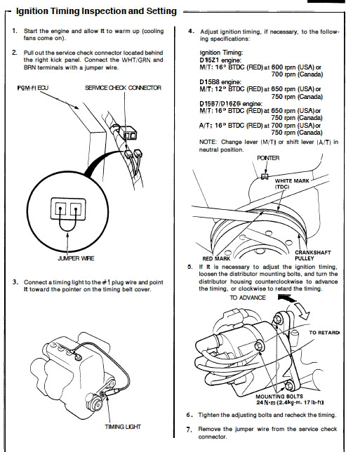

Ok round 3 setting timming
Old Feb 18, 2010 | 12:27 PM
