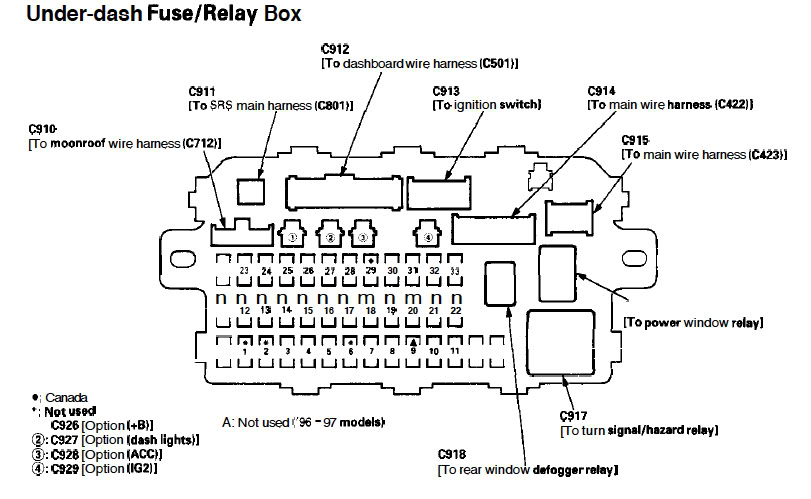

the check engine light is on, this may be a dumb question, but which fuse is the #15, do I count from the upper left over?

The diagram below should help you identify fuse 15. If it is blown, read this service bulletin:
http://www.tegger.com/hondafaq/tsb/civic/x99-029e.pdf
In addition, retrieve the CEL code(s) as detailed at the link in my signature.

I'm gonna check out fuse #15 today, a quick question (hopefully not a dumb one) does the fuse control if the alternator will be charging/working properly or is this fuse only for the light on the dash? I also need to check out the CEL code.
thanks
The fuse 15 circuit powers up the alternator when the key is on. If the harness is shorted out and the fuse blown, the alternator will not charge properly.
It may charge some. Many people having the fuse 15 problem reported that all the lights on the car surge dim and bright because the alternator is not regulating the voltage.
