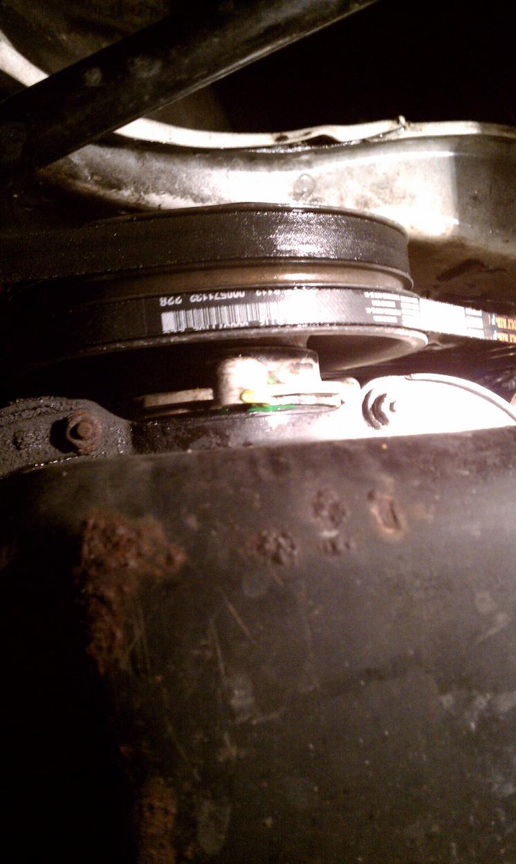

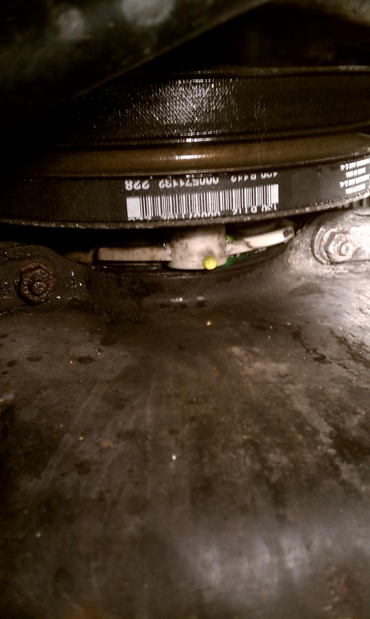

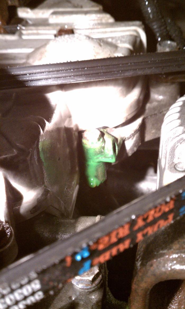

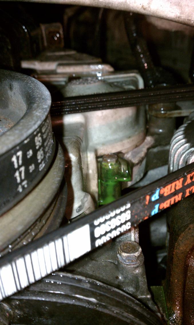

I have a coolant leak in my 89 Civic hatch. Where could it be coming from? These are the pics I took. If anyone has any questions to help me diagnose please don't hesitate to ask. Thanks in advance.

My guess is water pump.

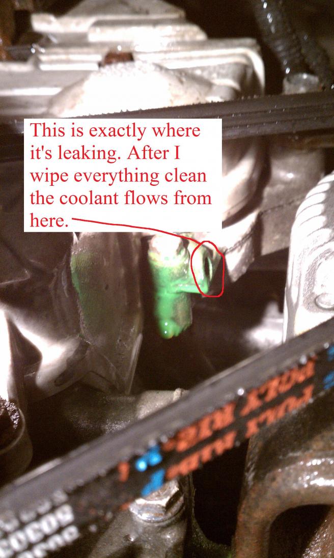

This is where it's leaking.

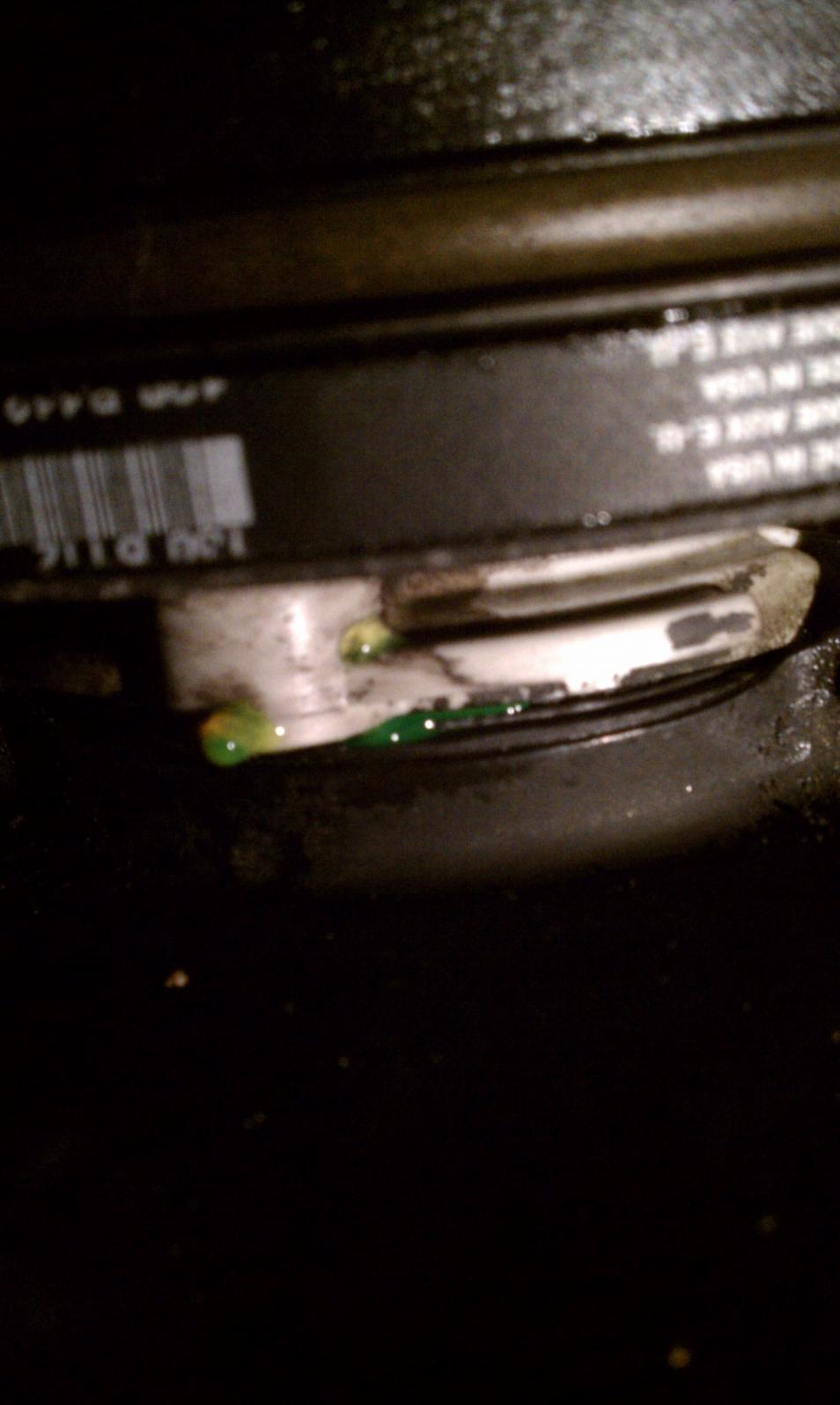

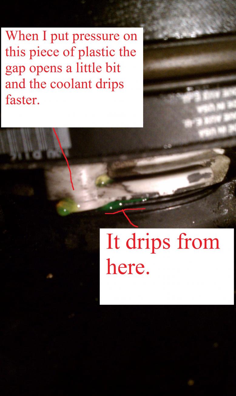

Here too.

That is a bad water pump. The hole is designed to direct away water that leaks from the seal. Replace it right away because it's going to get a lot worse. Unless your timing belt is really new, put a new one on while you're in there.

Are you sure mk? I'm assuming that the leak in the 2nd picture is from the coolant filling up inside the plastic cover.
