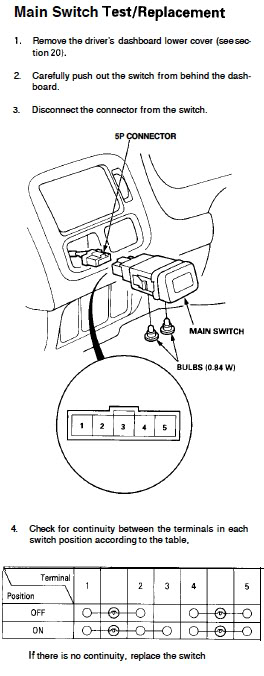

Need some more help fixing up the civic i just bought loving it. My on off control does not light up the switch to the far left under heat vent. any ideas out there.

Are you saying the the cruise control works properly but the indicator light doesn't turn ON? Is fuse 14 or 30 blown? Is the bulb blown?

yes the curse is working just the bulb in the switch is not working.

If the fuses are fine, here's how to access the bulbs:
