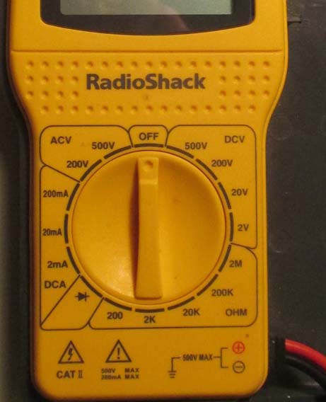

And is it safe to test the battery with a Radio Shack voltometer? @ 20V DCV?

It does appear that the battery is flat. But that could be because the alternator is not charging it, or that something ran it down.
See if it responds to a jump-start. Once started, let the engine idle with everything else off. Measure voltage at battery, it should be more than 13.5 volts. If the voltage is in the 12s, the charging system is not working.
