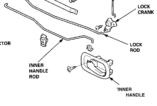

Remove one screw and then slide inner handle to the right to release:

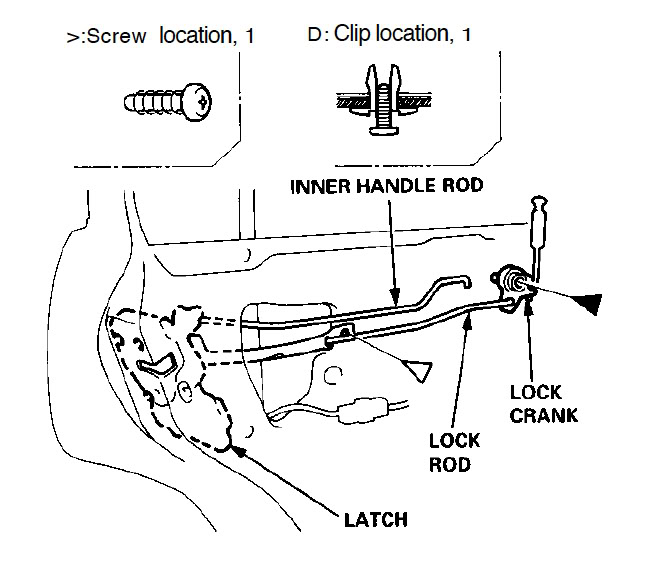

Got it. Thanks. How does the door latch connect to the door release? Do you have a cool picture of that? I see a catch on the door latch, and a catch on the release, but there's a part missing - may just be a rod of some sort.
Any ideas on the stereo?
Not sure what you are asking about the stereo.
Here's the latch picture:

Thanks for all the help. I got the door panel off and found what's broken - gotta get to pic n pull and get a new part.
