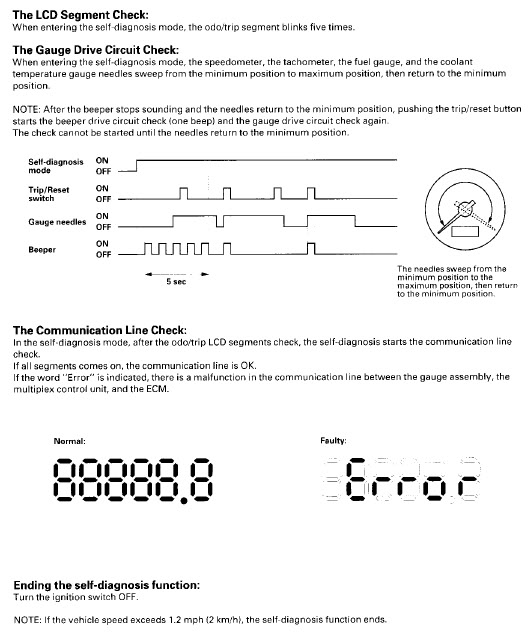

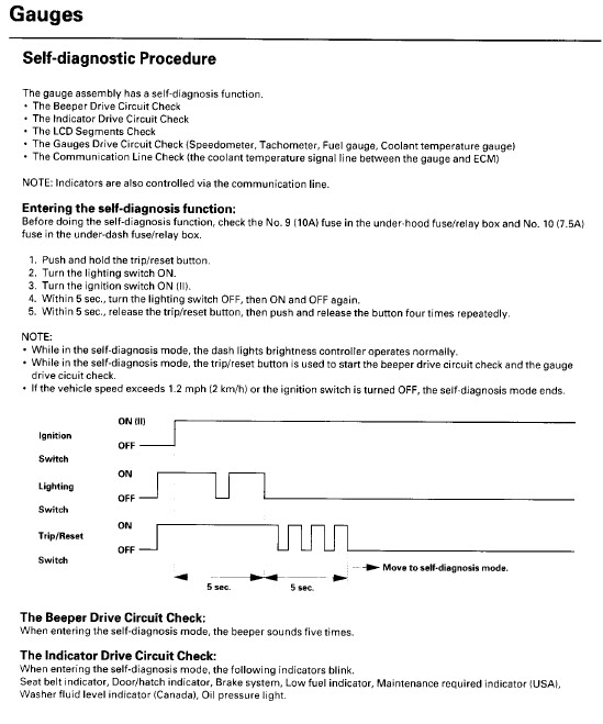

Maybe something will fall out from doing a self diagnosis test:
