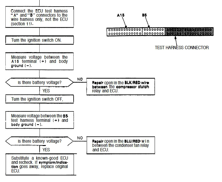

The 92-95 Civic manual (see manual link below) indicates that a special test harness connector is needed to test the A15 (BLK/RED) and B5 (BLU/RED) wires:
