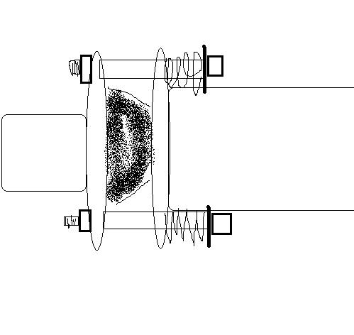

Too long is the problem. click the link to see what i purchased. image
the bushing part of the bolt comes in contact with the flange on the A pipe before the spring really compresses completely against the flange on the cat and the head of the bolt. see picture. my 1st grade art teacher would be proud!
I'm going to try and return it if they will take it back once it has been installed.... either way i need a new set of bolts. Will sealant help at all? is it something that is recommended for exhaust gaskets?

Sealant is not necessary if it's put together with the right parts. It is built that way so that it can move slightly when the engine shakes. If you used some sort of cement to seal it, it the cement would just crack when it moves.
