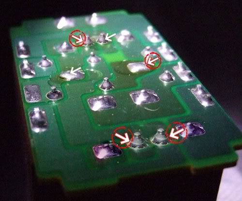

take the main fuel relay out and inspect it for hairline cracks in the soldering points

sorry its a 1995 civic..also could you tell me where the relay is..is it in the fuse box??
could it be a fuel pressure regulator problem??
Old Dec 17, 2009 | 06:56 PM
its under your dash on far driver side.

do i need to replace that or resolder it..
Old Dec 17, 2009 | 08:51 PM
you can spend 40$ and replace it or spend 0$ and resolder it... up to you
